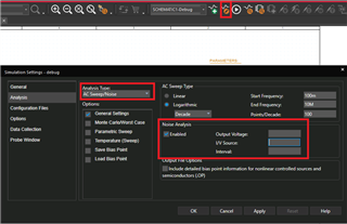

Noise analysis should be selected in the simulation profile -> Analysis type: AC Swee/Noise -> Check the Noise analysis box
