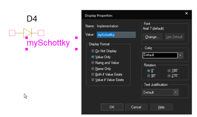

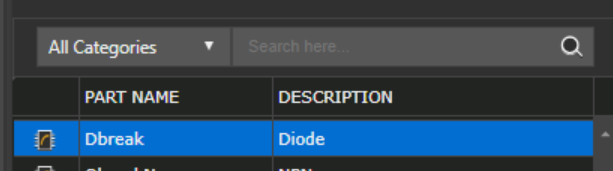

Simply place a diode breakout part:
Then change its "implementation" property to match the name of the .MODEL in your model file.

This was meant to be an example. Please replace with your model name and file name.
