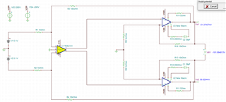

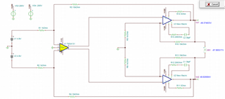

I used TINA to build a composite op amp structure, but there are some problems with the DC simulation results, when I use 4.9V and 5.1V differential inputs, the output composite is expected, but when using 5V, the output results are very confusing. Looking forward to your reply, thank you!

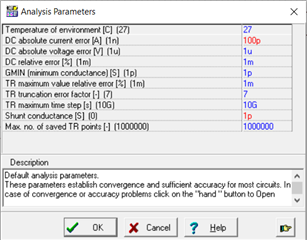

  • Hi Leonard,
    Thank you. I have asked the question according to the method you said, but the TINA-TI I use is a free version, so I don't know if I can get a reply. I found a solution is to set the DC absolute current error to 100p, I can understand that it may be a convergence problem, but I don't know why it is only 5V.
    Yue
