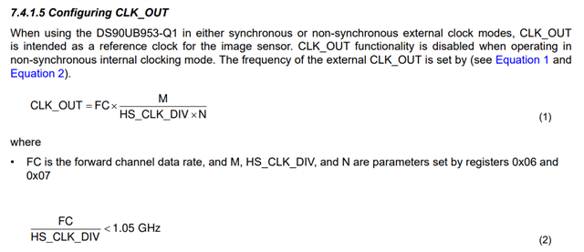

1.How can I setup the CLK_OUT to 24MHz?
Regarding to datasheet Equation 1 and 2 below. FC is the forward channel data rate, and M, HS_CLK_DIV, and N are parameters set by registers 0x06 and 0x07. it mean I need to write registers 0x06 and 0x07 then I can achieve 24MHz CLK_OUT. is it correct?

    1) This is correct. M, HS_CLK_DIV, and N are parameters set by registers 0x06 and 0x07, which you'd need to write to to set up.
