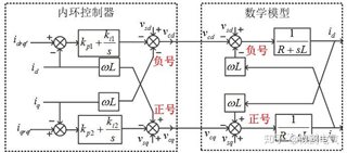

Question 1: the sign of the decouplling network.
As we all know, the sign of the decoupling network is different because of there are four different types transformation matrixs. Please refer the following info(Four different transformation matrixs and two types decoupling networks).
a) Four types transformation matrixs.
b) two types decoupling networks.
After studied, I believe that the first type transform and equal magnitude transformation is used in your demo code, which is shown as bellow.
After we calculate the mathematical model, the dq-decoupling based current controller and it's mathematical expressions are shown as following.
But in your demo code, the sign of the decoupling network is contrary to us.
1. Decoupling network in demo code.
Code implementation
TINV_vdInv_pu = (TINV_gi_id_out +
(TINV_vGrid_dq0_pos.d *
(TINV_VGRID_MAX_SENSE_VOLTS / TINV_VBUS_MAX_SENSE_VOLTS)) -
(TINV_iInv_dq0_pos.q * TINV_DECOUPLING_CONST * TINV_AC_FREQ_HZ ));
TINV_vqInv_pu = (TINV_gi_iq_out +
(TINV_vGrid_dq0_pos.q *
(TINV_VGRID_MAX_SENSE_VOLTS / TINV_VBUS_MAX_SENSE_VOLTS)) +
(TINV_iInv_dq0_pos.d * TINV_DECOUPLING_CONST * TINV_AC_FREQ_HZ));
Simplify expression
vd=+pi(s)*(id_ref-id_feedback)+ed-wL*iq
vq=+pi(s)*(iq_ref-iq_feedback)+ed+wL*iq
2. Mathematical expressions.
Question 2: The sign about the output PI controller.
As described in Question 1, the sign of the PI controller is negative, but in your demo code, the sign is positive.  So how about the reason?
Question 3: The detail modeling method about the dc-link voltage feedforward control.
DC-LINK voltage feedforward control is added in your newest code, could you please share some related modeling documents for us? And if it is possible, could you please share some comparison results with and without dc-link voltage feedforward control.
Question 4: Inverter mode and rectifier mode.
In demo code, TINV_idRef_pu = -1.0f * TINV_gv_vBus_out for PFC mode, TINV_idRef_pu = 1.0f * TINV_gv_vBus_out for inverter mode.
But in my opinion, d-axis represents the current magnitude (active component), while q-axis represents the phase angle between the converter's current and the grid side current (reactive component). So I think both for PFC mode and inverter mode, TINV_idRef_pu needs to be kept the same. We need to change the TINV_iqRef_pu based on the PFC mode and inverter mode, for example
TINV_iqRef_pu =0(PFC mode)
TINV_iqRef_pu =pi(inverter mode)

    Question 1 and Question 2
    I think that the sign difference that you are observing in both the feedfoward and the output of the current controller is coming from sampling of the current.
    Depending on how you measure the current, for example positive when enters in the AC stage and negative when current go out from the AC, the sign in the control loop change.
    Question 3
    In the new release, there will not be DC link feed foward because DC link current measurement is missing.
    Question 4
    Yes, you are right. Depending on the sign of the Id you control the active power to be negative or positive, so inverter or PFC mode.
    In general, in a AC/DC converter when you have a DC bus voltage controller, depending on the power flow in the DC link, the AC/DC will automatically understand if provide Id positive or negative.
    Sign of the Iq will just change the behavior of the AC/DC from capacitive to inductive because it changes the reactive power sign.
