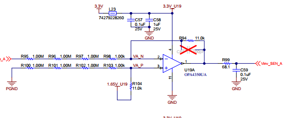

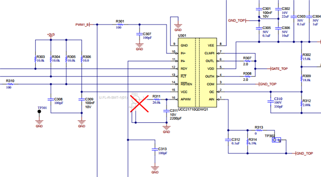

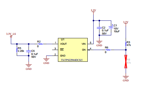

The difference between the ad software schematic and the provided pdf schematic.
Are these places with red cross marks open circuit or short circuit after removing the device?
Annie

Dear Annie,
it means that the component is not populated.
Best Regards
Riccardo

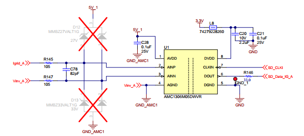

Hi Riccardo,
Regarding the schematic diagram of amc1306 (the first picture), does customer need to remove those unfilled components before soldering?
Annie
Hi Annie,
yes, having these diode will not affect the total performances..
In general, i suggest the customer when he is creating the boards to follow the variant option presented by Altium.
Best Regards
Riccrdo
