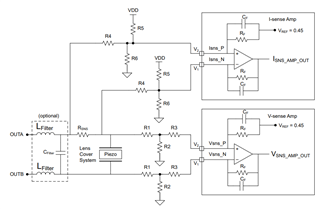

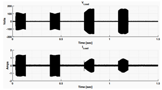

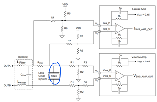

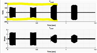

Are [mV] and [A] the correct units for the voltage and current values in this diagram?
Also which specific areas are VLOAD and ILOAD measuring in the diagram below?

    Q5: The units for the plots are volts and amps. This is the measured output from the EVM during a water cleaning cycle which is just measured across the load / LCS which I circled in blue.

    The ULC1001 is a PWM modulator. The DRV2901 is a gate driver, so my understanding is that it has the function of amplifying the PWM output from the ULC1001. The PWM is amplified up to 48 V by the DRV2901.
    The PWM signal output from the DRV2901 becomes a smooth sine wave via an LC filter and is applied to the piezo.
    Can you please tell me where I am wrong in my above understanding? It is not clear why a voltage of ±150 V is applied to both ends of the piezo.

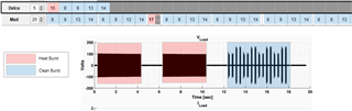

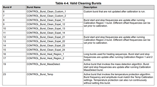

    How does the user need to change the Burst Enumeration? For example, WaterBURST has a series of sequences (8 -> 9 -> 13 -> 14). The understanding is that these should not be changed in a series of patterns.
    Related to the above order, I do not understand the difference between BURST8~11 and BURST12~15. I also do not understand the difference between BURST16 and BURST17 as well.
    If the user proceeds with development using the GUI, what steps need to be taken and which parameters need to be changed? It would be easier to understand if there is a procedure manual or WORKSHOP document on how the user should set up the GUI.

    Q5: Your understanding is correct, but the LC filter brings the magnitude of the impedance lower, which combined with the equivalent Q of the LC filter will lead to voltage gain. This is commonly referred to as a ringing system.
    Q6: Burst 8-11 and 16 are updated from the region 1 parameters from calibration. Bursts 12-15 and 17 are updated from the region 2 parameters from calibration. They are updated by the Fstart and Fstop Offsets that you can see and customize on the right side of the GUI. You can also change the number and order of the bursts in the GUI. It does not have to stay in default settings.
    As for development with the GUI, the detailed information for each section and explanation of the process can be found in the User Guide (sections 4 and 5). If using a lens cover separate than the TI LCS prototype, the first step would be to take an impendence sweep of your lens cover so you can update the frequency ranges accordingly. The default ranges are optimized the the TI LCS.

    LC filters are amplified to -200V~200V using the effect of amplifying the peak voltage at certain frequency components. From checking the datasheet, the LC filter is optional, so there may be cases where it is not necessary to place it. Am I correct in understanding that the LC filter is placed when a voltage gain is desired? Or is there a different criterion?
    You can also select a piezo and determine the approximate voltage by calculating the voltage gain from the Q-value of the LC filter. The value of the external resistor is then determined. Is it correct that this order determines the voltage value fed back to the ULC1001?

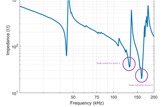

    The Clean Burst oscillates at a combination of different frequencies in Regions 1 and 2. We understood that the reason for this was to eliminate dead spots on the lens. We also understand that the lens oscillates around the resonance frequency.
    By the way, I think that these Region 1/2 frequencies are values near the resonance frequency, but I wonder how they are determined. Are the Region 1/2 frequencies the primary and secondary resonance frequencies? I am not very familiar with piezos, so I don't really understand if there are always first and second order resonant frequencies.

    Q5: Yes, the LC filter is placed when voltage gain is needed. Also, it will mitigate the ringing that would occur driving a pure square wave into the capacitive load which reduces EMI. For the second part of Q5 question, can you clarify what resistor you are talking about? Are you referring to the IV sense?
    Q6: Yes, the region 1 and 2 frequency ranges declared in their respective bursts are around the resonance frequencies. These are determined be taking an impedance sweep across the LCS. We do this using an impedance analyzer and sweep from 20kHz to 200kHz.

    Q6 : For example, in the default settings of the GUI, Region 1 shows around 120 KHz and Region 2 around 140 KHz. Am I correct in understanding that in this case the resonant frequency is around 130 kHz?In other words, is there a resonant frequency between Region1~Region2? Also when performing a frequency sweep, the resonant frequency will be the highest voltage value by IV sensing, correct?

    Q5: You can find information on how to calculate the IV sense resistive divider network in the ULC1001 datasheet (section 8.5.2 Voltage and Current Sense Circuitry). These IV sense pins are sensitive, so they need a voltage divider network to reduce the voltage.
    Q6: No, these are two separate resonance frequencies. In the impedance response of the LCS, which is taken on an impedance analyzer, you can see the resonance peaks and note the frequencies, but this is just for the LCS. The addition of the LC filter will shift this frequency slightly left and other factors such as temperature could slightly change it as well. Calibration bursts 2 and 3 are set with fstart and fstop values which are ranges around a frequency noted from the LCS impedance sweep. Burst 2 updates the region 1 parameters, and burst 3 updates the region 2 parameters. When calibration is run, burst 2 will do various measurements using IV sense and update the region 1 parameters. Similarly, burst 3 will do various measurements using IV sense and update the region 2 parameters. Note that these measurements are only done within the bursts declared frequency range. Below is an example impedance sweep for the LCS.

    I understand that I can check the resonance frequency using an impedance analyser. When actually using the GUI for development, the resonant frequency can be set automatically for Range 1 and Range 2. So checking the frequency with an impedance analyser is optional in the ULC development flow, is it not? Also, in the USS of the MSP430 I can view the sweep measurement graphically, is there such a function in the ULC?

    Q6: "When actually using the GUI for development, the resonant frequency can be set automatically for Range 1 and Range 2" - No
    In the GUI, the default frequency ranges for burst 2 and 3, that update the region 1 and 2 parameters, are optimized for the LCS by taking an impedance sweep externally. If you are creating a new lens cover system, it is recommended to take an impedance sweep to then update the burst 2 and 3 frequency ranges as they will be different from the TI LCS. The ULC device can not take a sweep from 20kHz to 200kHz and find the true resonance peaks, which is why we use an impedance analyzer. Using that information, we then provide the ULC device with smaller frequency ranges around the peaks. You also want to do this external sweep to properly set up the temperature detection for new LCS, as these defaults in the GUI are also optimized for the TI LCS.
