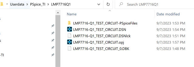

  • Hi Josh,
    I ran a sim on LMP7716-Q1 test circuit. I modified it and ran again. I then downloaded and ran without a problem.
    Did you make any changes to the .lib file?
    Here's my project folder for this adjusted circuit (I just changed the load R and C.
    David

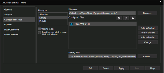

  • If the LIBRARY option is checked, the .out file will show you the definition of every model (primitives or subckts) and which file it comes from.
    I downloaded the project (snom093b.zip) and unpacked it, then updated the simulation profile:
    This simulated alright.
