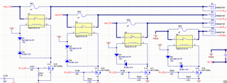

1) Fuse and relay.
When you see the below graph, there is relay and fuse.
But I am not sure how it can prevent from the large current.
Based on my understanding , when the relay is connected and large current happend, the fuse might be disconnedted but the relay is still connected.
So I think the circuit would have damage...
Could you explain it?

  • Hi Mingi,
    resistors and relays are used for precharging circuit of the DC link. There is no intention to use them as fuses.
