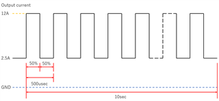

Is there anything to be careful about when designing for high current (12A) in the term (10s) as shown below? The typical current is 24V/2.5A in steady state.

    It looks like the current is at 12A for 250usec.  To the converter, this is "steady-state" and not a transient.  The converter current limit will have to be set to supply 12A of current.  The inductor will also have to be selected to not saturate with 12A of current.  You will need sufficient output capacitance to provide an acceptable load step response of the output voltage.  You need to evaluate the heating of the FETs for this 10 second period.  Also, how often does this 10 second period occur?  This period will also affect the thermal performance.
    I was wrong. You are correct.
    I will confirm it to the customer.

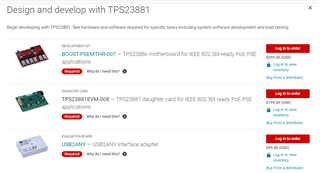

    Also, Is there a reference design on the PSE side? Customers are particularly interested in the output overcurrent and overvoltage detection features.

    I confirm about following question.  The customer says it will occur in 90 seconds. In other words, 10 sec->90 sec repeats periodically.

    TPS23881 can be used as PSE for Class-8 power. The following 3 parts will be needed for TPS23881 test kits. You can check the mother board and daughter card references designs. Please let me know if you have further questions.
    BOOST-PSEMTHR-007
    TPS23881EVM-008
    USB2ANY
    Diang

    Customers are particularly interested in the output overcurrent and overvoltage detection features. Is EVM considering such protection?
    Also, Is it possible to use the TPS2373 in the following conditions? Or, if there is a device more suitable than TPS2373, could you please introduce it to me?

  • Masa,
    It is difficult to say what the thermals will be with this duty cycle.  The board temperature will have to be measured.  The lowest risk would be to design for 12A steady-state current.
    David

    Understood. I would recommend that customers design with a steady-state current of 12A.

  • Masa,
    The TPS23881 has over current protection.  If you want over voltage protection on the PSE output, I think that would have to be done on the converter sourcing the 56V to the TPS23881.
    David
