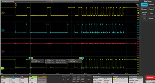

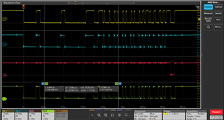

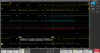

  • Hi Thomas, my Delay line has a delay of 250ns rn. The strange thing is that 5Mbps works with some can messages and with others it  doesn't.
    For example:
    speed : 4Mbps
    msg: 02 02 02 02
    direction: CAN1 → CAN0
    --- RX1
    --- TX1
    --- TX2
    --- RX2
    speed: 5Mbps
    It can be seen that everything works like it should.
    But...
    speed : 4Mbps
    msg: 21 21 21 21
    --- RX1
    --- TX1
    --- TX2
    --- RX2
    speed : 5Mbps
    --- RX1
    --- TX1
    --- TX2
    --- RX2
    No ACK for receiver. I assume that this has nothing to do with the delay line because as far as I understand it the delay line is only needed to block the RX Line. But the ACK doesn't get blocked it is not sent by the receiver.
    Any ideas/suggestions?
    If I understand your last comment right my delay line should be
    Propagation delay Txd to Rxd + Propagation delay ISO * 2  > x > 200ns
    in my circuit this would be:
    120ns + 11ns * 2 > x > 200ns
    142ns > x > 200ns
    right?
    I testet it with 190ns before but with smaller delays then my current setup it stops working at all.
    kind regards, Jonas
  • Hi Jonas,
    Thank you for providing the scope plots.
    I do agree that the delay line has most likely no influence at 5 Mbps in the failing case. I also think that the receiver should send the ACK in case he did receive the signal well.
    So maybe this is the issue here. Somehow the data stream on CAN0 side is getting distorted so the the receiver does not understand the message and does not provide the ACK.
    Do you have any measurement instrument to see/sniff the message on the CAN0 side? Is there maybe some CAN bus termination resistor missing?
    I would suggest to look at the CAN side next, to identify why the CAN receiver does not sent the ACK. Because right now the CAN message should be 1:1 routed through the two CAN transceiver and the isolation without getting broken.
     Thomas
