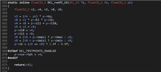

Hi Andreas,
Thank you for the fast reply.
I have another question.

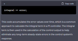

I am trying to make a parrallel PI structure. Is there a library to use an integrator in CCS?
Are is it possible for you to show me an exemple of integrator? I found exemple on the internet, but it look too simple...
Here error = setpoint - feedback;
There must be an integrator in (DCL_runPI_C6), can you explain it to me?
thank you for the great support,
Vincent Beaulieu-Gagnon
Hi Vincent,
DCL_runPI_C4 is a function for parallel PI structure. I do not think we have one only with integrator.
Thanks and regards, Pawan

Vincent,
Did you try using our PI function with Kp=0? That would essentially serve as an integrator.
Sira

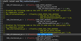

Hi Andreas,
I can't find the sampling frequency used for DAB_vSecSensed_pu. Can you help me find it?
thank you
HI Vincent,
All control loop relevant measurements are sampled with the switching frequency. So with 100kHz.
They are read out at the beginning of DAB_runsISR1() with the DAB_readSensedSignals() function.
Andreas

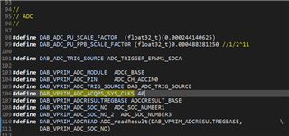

Hi Andreas,
So the sampling frequency is 100 kHz. I am trying to understand how it's done?
Here is the road i used. But i can't find the line that define the sampling frequency to 100 kHz.
Also what is (DAB_VPRIM_ADC_ACQPS_SYS_CLKS 40)?
thank you
Hi Vincent,
The ADC is setup in the DAB_HAL_setupADC() function.
In this function the ADC Module, ADC Channel, ADC start of conversion, ADC trigger and the ADC acquisition time is defined
As a trigger source the EPWM module1 which is used for the first leg on primary side is used. That's why its 100kHz.
This is done in DAB_HAL_setupTrigForADC().
DAB_VPRIM_ADCREAD is the macro to read out the ADC Results register at the correct spot.
DAB_VPRIM_ADC_ACQPS_SYS_CLKS is the number of cycles for acquisition. This is the time how long the sample and hold capacitor inside the ADC module is charged for, before conversion is started.
