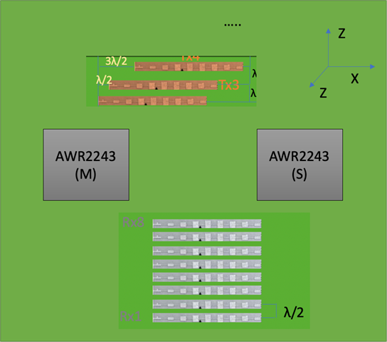

Starting from the TIDA020047 reference board, I would like to improve the field of view (FOV) and resolution on the elevation axe. I'm seeking your input on the antenna placement, as described here.
Could you please advise if it's possible to adjust the antenna's placement without affecting the radar's radiation or any other effects?
