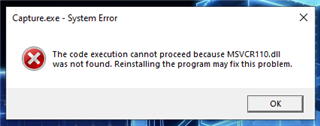

Hi TI Team,
I tried to install the PSpice Simulation tool twice but I am getting the same error mentioned below.please let me know the Solution for this.

Hi Arun,
Did you uninstall first?
David
Hi Arun,
Found this:
The software requires Microsoft VC++ to run. Would you please check if that is installed on your computer?
David
Further suggestions to help fix this:
It seems some redistributable files have not been installed/configured properly with installation.
Could you please ask user to perform following steps:
Now reboot machine and try to launch Capture and see if it helps.
David
