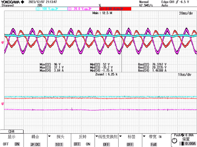

I built a TIDA01606 hardware platform for experiments, and the off-grid on-load experiment was normal, but there was a problem when I did the grid-connected rectification.
On the AC side, I connected a three-phase voltage with an effective value of 20V, and a 100 ohm load on the DC side, pre-charged the DC bus capacitor before the experiment began, and then waited for the phase locking to be completed
After closing the relay, we are conducting a rectification experiment, which simulates that the three-phase voltage emitted by the power grid is biased and the current is non-sinusoidal (the oscilloscope waveform diagram is shown below). Point N on the grid side is not connected to N on the grid, and the relay remains disconnected during the relay pick-up operation

     the problem seems to have found, today I found the AB phase drive Q4 Q3 at the DC-DC conversion lamp did not light, I tested and found two mosfet gate source pole short circuit, mosfet bad, I replaced and then did a little experiment, in my reference current to the reference current has not been cut into the load, the AC to the rms value of the voltage 20V, the DC voltage rises to 500V, after the second experiment, I cut the load to the reference value of the current to give the order of the reference value, to get the C-phase of the voltage and current, as well as the value of the DC bus voltage is shown in the following chart, this kind of is normal, right.Voltage in purple, current in red
    But the current is not balanced and I don't know what causes it
