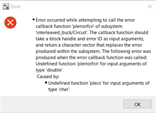

getting error when open the block
Hi Kameswara,
Is the model you use a standalone version or a blockset version?
Bowen
I have only a standalone version. so I think I cannot call plecs from Matlab. DO u have any chance to make a stand-alone version? also, can you provide any doc related to changing battery parameters and MPPT implementation doc
Hi Kameswara,
Yes, we have standalone version of the simulation, please provide your mail, and i can send it to you.
Regarding to battery parameters, maybe you can refer to PLECS website, MPPT implementation you can refer to the design guide.
Bowen
Thank you, Bowen, For your help. you can mail me at oks1988@gmail.com or kameswarasatyaprakashoruganti@sd.taylors.edu.my
