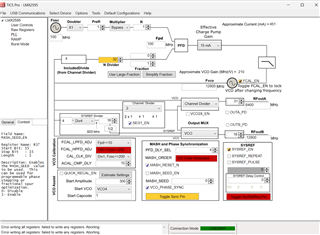

I have downloaded the software TICS pro and am now preparing to set up a 2.5-5GHz output from a 100MHz input. However(LMX2595), I do not know how to set it up and have not found the software documentation. Can you provide some help

I have attached the user guide https://www.ti.com/lit/ug/snau219b/snau219b.pdf?ts=1705680428656&ref_url=https%253A%252F%252Fwww.google.com%252F which is a quick start guide.

Can you accomplish the ramping settings as found on page 14 of the user guide? What is giving you issues?
Please note with such a wide range, VCO calibrations will be required. What is your step size?
