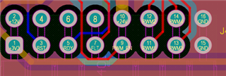

Dear TI,
I have a gate driver question.
There are RST, RDY, FLT signal.
What is the meaning?
Those are the input?
And lastly, to operate the gate signal should send the signal to RDY, RST, or FLT?

RST is the reset signal coming from the MCU. It resets the fault or enable the gate driver
RDY is the ready signal (Power good for VCC-GND and VDD-COM)
FLT is the fault signal. This signal is going toward the MCU.
