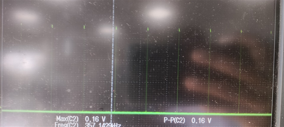

The gate voltage of this design has been given here
- It's not a square wave and output voltage is increasing

It is hard to help troubleshoot with this small amount of information:

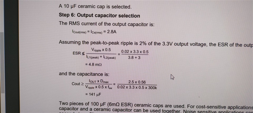

I have one more doubt
There are 2 equations to calculate output capacitor one I have got from datasheet of tps40210 and another one from sepic converter design note AN-1484
Which should I take to calculate output capacitor?
The output capacitance selection depends on your application requirements. If you expect to have load transients it's better to work with the equations from the TPS40210 datasheet as it provides some more margin (or you use a more precise impedance based calculation method like here: https://www.ti.com/document-viewer/lit/html/SSZTCQ4). If you only care about ripple, then take the equation from the app note.

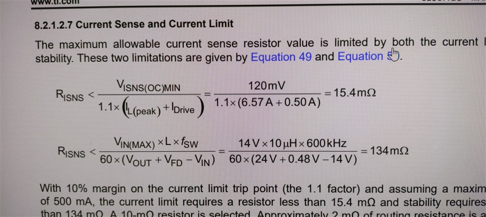

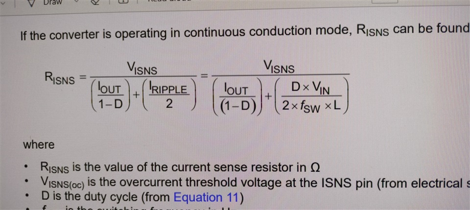

To calculate the sense resistance you just calculate your peak current through the MOSFET and add some margin. You can use a tool like TI Power Stage Designer (www.ti.com/powerstage-designer) to do this.
The second equation you posted is for a boost converter, so it won't fit for a SEPIC design. You can look up equations from the Power Topologies Handbook (https://www.ti.com/seclit/ug/slyu036/slyu036.pdf), too.
If your maximum peak current (including efficiency) is 3A, you should still allow some margin for load transients and temperature effects, e.g. 30% more. The equation you are using is correct, but you also need to check the conditions when VOCP is 120mV or 180mV.

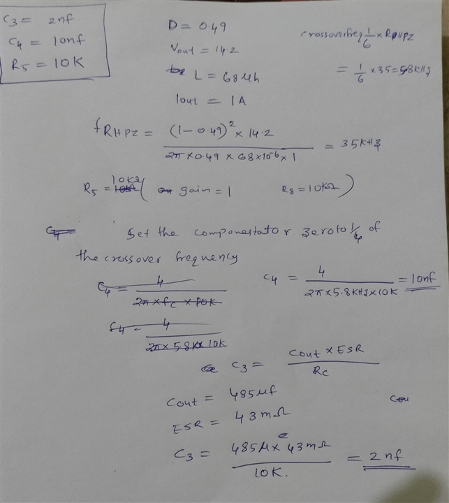

could explain how to calculate voltage feedback compensation?
I HAVE TRIED WITH POWR DESIGN TOOL BUT I NEED TO UNDERSTAND THEORTICALLY
IS CROSS OVER FREQ IS 1/10 OF SWITCHING FREQ?
IN YOUR CALCULATION ZERO AT 0.15KHZ
AND POLE AT 15KHZ
The Power Stage Designer Tool does not support the SEPIC topology in the Loop Calculator as the SEPIC transfer function is quite complex.
In general, you can only go for 1/10 of the switching frequency, if your error amplifier allows such a high bandwidth (1/100 of the GBWP is reasonable) AND if it is a buck derived topology.
If it is a boost/buck-boost derived topology (e.g. Flyback, SEPIC), you have to consider the right half plane zero (RHPZ) and then the maximum achievable crossover frequency is 1/5 to 1/10 of the RHPZ frequency.
For these more complex topologies it is good practice to start with a conservative compensation network and then optimize it in the lab by using a network analyzer.
For a battery charger you don't really need a high bandwidth in the voltage control loop as there won't be any quick and large changes to be expected.
Good practice is to put the crossover frequency to 1/10th of the RHPZ, the zero to 1/10th of the crossover frequency and the pole on the RHPZ frequency. With that you have the full phase boost of the zero at fco and the pole will only start to reduce the phase slightly above fco. For your case that would mean having the zero at 350Hz, fco at 3.5kHz and the pole at 35kHz. Please keep in mind that this recommendation would be for voltage control only, in a charger application it can be beneficial if the voltage loop is slower than the current loop.
