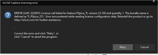

PSPICE-TI shows lis error on VPN. Any help please.
Hi Piyush,
Can you post the error message here?
In the bottom of the box, Insert->Image/Video/File.
David
Thanks. I've got another just like this.
Did you just upgrade PSpice for TI? The license is looking for 231, not the older 174.
Also, please check to see if you have a license at the following location (text file)
C:\Users\<%User_Profile%>\AppData\Roaming\Cadence\VBL\TI_PSpice_231\license
David

Hi David,
Thanks for the information. Yes I did follow uninstalling- Reboot-Install again before opening this thread. I have checked the location mentioned an d. txt file is at specified location.
The tool is working when i work on site but doesn't get connected when I connect office network through VPN.
Ah, I think that's the key. VPN can mess up some proxy settings. Usually that's just during install though, not running the program.
Let me follow up on that.
David

Hi David,
Thanks for the guideline. I did follow the steps but problem persist, i have attached log file here. SW works well when i am at onsite, but throws an error when login through VPN.
