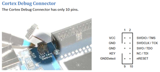

I recently purchased an XDS110 Debug Probe (TMDSEMU110-U) to program/debug our custom board, which features an MSPM0L1306 MCU. It is equipped with a standard ARM-Cortex Debug Connector (10-pin), as shown in the image below:
To interface with this, I used the CM10 Pin Adaptor that came with the debug probe to program the MCU on our board. However, it didn't work, and upon investigation, I discovered that pin 1 of the adaptor is NOT actually supplying power to the board. (I also found that the pin is named 'VTREF' instead of 'VCC'.)
Is the MCU expected to be powered up separately before programming/debugging it with the XDS110 Debug Probe?
Is there any way I can make the XDS Debug Probe supply power to the board so it can program/debug the MCU without an external power source?
