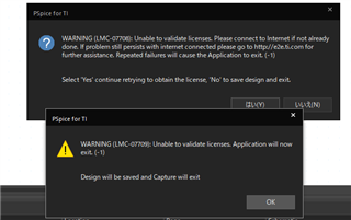

When I open Pspice for TI ,the following picture appeared
Hi Hongyu-jiang,
Something similar happened to me.
I uninstalled, rebooted, and then reinstalled. That fixed it for me. Please give that a try and let me know if you still have this issue.
