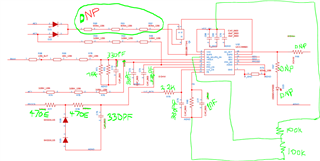

  • Hello TI,
    thanks for ur reply
    auxiliary bias mode.
    i have an attached the UCC29950D IC section and PFC section. kindly review it.
    While turn ON AC,
    slowly increasing the AC 0 to 100VAC.
    Auxiliary power supply voltage VCC=13.2V
    AC-DET pin voltage showing =0.2v (almost 0V)
    MD-SEL/PS-ON pin voltage applied=6.6vdc for PFC section turn on.
    kindly guide me to take off the project.

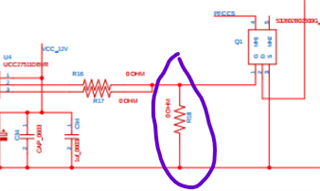

  • Hello K.Prabhu,
    Thank you for providing the updated test information and marked-up schematics.
    Following the connections, I do not see any problem with the schematic diagram.  However, it is low resolution and the text is small and fuzzy.  I can't read the values very well.
    When you say that PFC-GD pin pulse is not coming, are you probing the PFC-GD pin or probing the gate of the MOSFET Q1?
    This part from MOSFET gate-to-source looks like 0 ohms (but it is difficult to read).
    If it really is 0 ohms, then there can be pulses at the PFC-GD pin, but no pulses at the MOSFET gate.
    Please check this.
    That brings up another point.  When debugging a prototype board, the board may reveal an error in the schematic, OR, the schematic may be perfectly good but there is a problem on the board itself.
    If the schematic values and connections are all good, then examine the board for wrong components, backwards diodes, or missing parts.
    Some subtle problems are the result of short-circuits from solder bridges or from open circuits due to tool damage or a scratch across narrow tracks.
    A ceramic capacitor may be shorted or low impedance due to cracking from board flex.
    Please look for such things.
    Also, if you have not already done so, please try replacing the UCC29950 with another one, in case the existing one became damaged somehow.
    Ulrich
  • Hi Ulrich,
    thank you for your response. your wright. schematic values wrong. but gate source resistor pull down 10k. pull up 3.3ohms only.
    we tried replacing with new UCC29950D IC. the PFC-GD came while turn on the AC, but after that PFC-GD gone. How to make sure continous work? kindly guide me

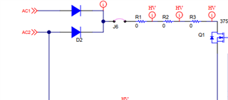

    Issue on TI board:
    1...AC1,AC2 track are burned, while turn-on .Also D1,D2 diodes are failed. im using PMP11237 (SELFBIAS MODE) design.same PCB layout PCB.UCC29550DR IC. components same, including transformer also. I thing The IC have an issue.
    I checked another board also. I was removed the D1,D2 diode, the circuit do not have an issue. only when enable D1,D2 diode that time only issue. i means once go for turn on the IC only the issue with IC. plz  help us.
  • Hello K.Prabhu,
    What kind of MOSFET are you using at Q1 (shown in the snippet above)?  What is its part number?
    Q1 should be a depletion-mode MOSFET, not an ordinary enhancement-mode MOSFET.
    I am not sure how an enhancement-mode FET will react during start-up, but I suspect that its Gate voltage may exceed its Source voltage by more than 0.3V.
    The Absolute Maximum rating of V_SUFG is V_SUFS+0.3V.
    One other possible cause of failure is if you are testing with a DC input voltage.   The SUFG/SUFS self-bias mode requires only an AC input because zero-crossings must be detected at SUFS.   A DC input will have no zero-crossings and the UCC29950 will react as if AC had been removed and will start the X-cap discharge process.  With DC input, the X-cap voltage can not be discharged and the IC will keep trying to discharge so at some point one of the devices in the discharge path (either Q1 or the UCC29950) will over heat and fail, leading to the other device failures, too.
    Please make sure that you are using a depletion-mode MOSFET and only AC input during your testing.
    Ulrich

  • Hello K.Prabhu,
    Thank you for the additional information.
    It could be that a previous failure at start-up (due to unknown problem) damaged more parts than you thought.
    Previously, U1 pin 4 (SUFG) may have been shorted to pin 5 (SUFS) or pin 3 (VCC) by a solder ball or other solder short.
    Whatever the previous cause, if the Start-Up Fet (Q1) fails as a short-circuit, it will allow high voltage through and will probably damage all parts on the VCC rail, including the VCC filter capacitors.  Any one of them could be holding VCC low to about 0.5V if you did not find all bad parts after the previous failure.
    I recommend to remove all components connected to VCC and replace them with new parts.
    Make sure the pads are clean and no solder bridges exist after installing the new parts.
    I also suggest to verify that the new PFC controller starts up by applying a DC bench supply to Q1 drain while keeping AC power off.
    Start the DC supply at 0V and dial it up by hand high enough so that VCC reaches the start-up threshold.
    If that works, then remove the DC supply and apply AC input.
    Ulrich

  • Hello K.Prabhu,
    The UCC29950 will fail after the BSS126 fails, because high voltage becomes applied to the SUFS and SUFG pins.  They are not rated for high voltage.
    The high-voltage depletion FET is intended to block the rectified AC voltage from the SUFS input.  UCC29950 failure is follow-on damage from depletion FET failure.
    So the question is what causes the BSS126 to fail?  Well, that FET must be experiencing some kind of overstress that it cannot sustain.
    It could be overvoltage on Vds due to surge voltages or spikes on the AC line, or maybe excess drain-source current leading to excess TJ rise, or excess Vgs from spikes of some sort.
    Voltage spikes on the AC line may come from contact-bounce of a relay or switch when AC is turned on and high current flows through stray line inductance.
    The bouncing of the contacts can interrupt the current and the inductance generates excessively high voltage to keep the current flowing, for example.
    Excessive FET current may come from additional loads on VCC other than simply the UCC29950, or if a massive VCC capacitor is in place.
    I don't know what can generate excess gate voltage, but that is a possibility that should be investigated.  Maybe a 1nF cap should be placed gate-to-source on the depletion Fet to reduce the probability of spikes.
    Please investigate the stresses on this device, including during steady-state, but especially at turn-on and turn-off of AC power.
    Ulrich

  • Hello K.Prabhu,
    Auxiliary bias mode has no intrinsic protection against transient surges.  Protection against line transients and surges must be added externally.  This is usually done a the AC input with MOVs, TVS, Gas-spark tubes, and similar protection devices that normally protect the entire power converter.
    If this protection is not sufficient to protect the BSS126, then additional protection can be added around the BSS126 specifically.
    But first, it must be determined which stress is damaging the depletion FET.  Excess Vds?  Excess Vgs?  Excess drain current?  Excess dVds/dt?
    You can't provide a protection solution until you know what to protect against.
