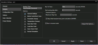

I am trying to simulate my design using PSPICE FOR TI and LM5117 spice model.
the simulation takes very very long time ( 1 Hour and plus for showing the results). My run time is only 10ms..
is there a way to speed up the simulation?

Hello Evgeni
If you change the simulation option, it can cause a convergence error. Please keep the original simulation option with 'Auto Convergence' enabled.
Usually, the simulation speed can be improved by using a large memory desktop without running other program except the PSPICE-FOR TI.
