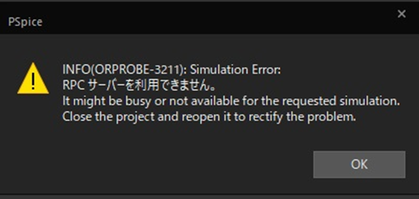

Hi team,
My customer has been facing the error of PSPICE FOR TI when try to run the simulation. I have attached the error messages below. Could you please kindly look at them to investigate the cause of the errors? I suspect the customer cannot properly download the library on their PC from web.
Shunsuke Yamamoto
  • Hello Shunsuke,
    Since there seem to be several problems, can you have your customer try the following first?
    Uninstall PSpice for TI
    Re-boot their computer.
    Make sure there is not an environment variable set for Cad_PSpice_TI_Regr_Srvr
    Re-install PSpice for TI.
    At that point, they should be able to browse the TI part library and download any designs/sim profiles available.
    Please let me know if that doesn't work, and we will proceed from there.
    David
