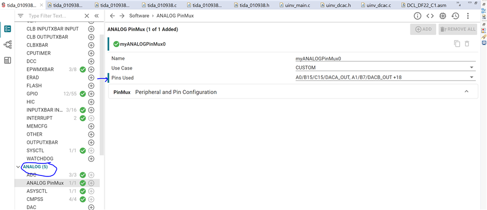

I have received TIDA-010938 early version firmware from MSS but unfortunately I am unable to compile it successfully.

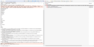

The compilation error I received is shown on the image below.
subdir_rules.mk:16: recipe for target 'build-402855905' failed
Error: cannot set 'useInterfacePins' to ['A0/B15/C15/DACA_OUT', 'A1/B7/DACB_OUT', 'A10/B1/C10', 'A12, C5', 'A2/B6/C9', 'A3, C7/B9', 'A4/B8', 'A4/B8, C14', 'A5', 'A6', 'B0/C11', 'B11', 'B2/C6', 'B3/VDAC', 'B4/C8', 'B5', 'C1', 'C14', 'C2/B12', 'C3/A7']: No option named A4/B8, C14 defined, valid options are

    at setHelper (D:\dev\ti\ccs\ccs\utils\sysconfig_1.19.0\dist\webpack:\src\pinmux\services\objectManagers\proxyHandlers\managedObjectProxyHandler.ts:162:10)
    at Object.set (D:\dev\ti\ccs\ccs\utils\sysconfig_1.19.0\dist\webpack:\src\pinmux\services\objectManagers\proxyHandlers\managedObjectProxyHandler.ts:29:10)
    at scriptFunc (D:\dev\ti\C2000Ware_DigitalPower_SDK_5_02_00_00\solutions\tida_010938\f28003x\sinv\tida_010938.syscfg:287:30)
    at cb (D:\dev\ti\ccs\ccs\utils\sysconfig_1.19.0\dist\webpack:\src\pinmux\services\scripting\runScript.ts:112:7)
    at withDeprecatedAccess (D:\dev\ti\ccs\ccs\utils\sysconfig_1.19.0\dist\webpack:\src\pinmux\services\deprecatedAccessGuard.ts:14:10)
    at runAsUserScript (D:\dev\ti\ccs\ccs\utils\sysconfig_1.19.0\dist\webpack:\src\pinmux\services\scripting\scriptingGuard.ts:61:3)
    at iteratee (D:\dev\ti\ccs\ccs\utils\sysconfig_1.19.0\dist\webpack:\src\pinmux\services\scripting\runScript.ts:110:5)
    at baseEach (D:\dev\ti\ccs\ccs\utils\sysconfig_1.19.0\dist\webpack:\node_modules\lodash\lodash.js:530:11)
    at Function.each (D:\dev\ti\ccs\ccs\utils\sysconfig_1.19.0\dist\webpack:\node_modules\lodash\lodash.js:9409:52)
    at D:\dev\ti\ccs\ccs\utils\sysconfig_1.19.0\dist\webpack:\src\pinmux\services\scripting\runScript.ts:108:6
gmake: *** [build-402855905] Error 1
gmake: Target 'all' not remade because of errors.
I have not modified any CCS settings or the project settings. Is there anything I should do in order to be able to compile the firmware?
