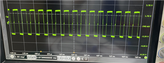

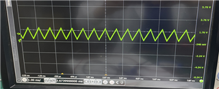

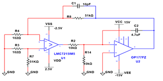

I saw a good post on EDN that studies how to test the characteristics of operational amplifiers. However, I found that comparators cannot be tested in a closed-loop configuration like operational amplifiers because the output of the comparator keeps oscillating. How should I test some characteristics of comparators, such as VOS, bias current, PSRR, and other parameters?
EDN Op Amp Testing Basics Link: https://www.edn.com/the-basics-of-testing-op-amps-part-3-configurable-circuit-tests-op-amps/
My test results, Figure 1 LMC7215 output, Figure 2 OP177 output
