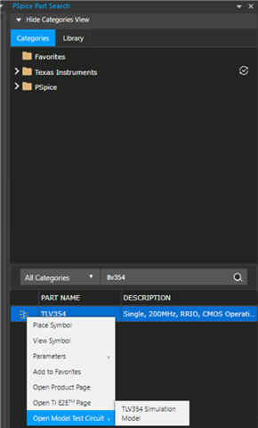

I'd like to add TLV354 opamp library to Pspice for TI
How can I do that?
Please Let me know.
How can I do that?
Please Let me know.
Enter the part # in the search field under PSpice Part Search.
Right-mouse-button click on the symbol and open the Test Circuit.
You are ready to simulate!
