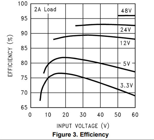

I need to replace the components of a LM2576HV TO220 based buck power supply with these specs Vin: 48V, Vout:45V, Iout:1.5A
I would like to use an LM2592HV which would allow me to reduce the inductance by having a switching frequency of 150kHz.
I wanted to simulate this power supply with WEBENCH®︎ POWER DESIGNER but they won't accept solutions with a voltage higher than Vout=40V
Can you confirm that it is not possible for LM2592HV to have Vin = 48V and Vout around 45V?
Thank you

  • Hi Marco,
    I tried to replicate this on WEBENCH with above conditions. Even i see similar behavior.  However i believe 48Vin and 45Vout is feasible. Here is a efficiency graph of multiple inputs w.r.t input voltage.
    For 48Vout, the input can be as low as 50Vin. So 45Vout with 48Vin is very much possible as per this graph.
    Nitya

  • Hi Marco,
    WEbench does not accept the above use cases as mentioned previously. If customer is ok, we can review the schematic  once it is done.
