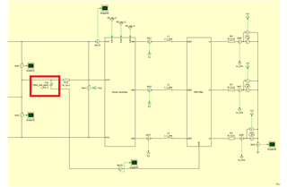

Hi, I have some questions regarding the simulation file.
In the PLECs simulation, there is a capacitor Cfdck_mid_point connecting the DC bus midpoint to the filter caps in the LCL. This cap is not present in the design guide. Is it a parasitic cap? Is it needed in the final design? How can I determine an appropriate value for this cap?
Also, the grid side inductor is a common core inductor. Is it recommended to use a common core inductor or just 3 seperate inductors? How to determine the value of Lcommon?
  • Hi Tom,
    For our up coming design update, we're planning on having this Cfdck_mid_point cap for our our new design (1.5uF).
    This was based on our simulation for the emi filter.
    The engineer who designed the common core choke is currently OOO until next early month.  I will have to ask him when he gets back on the design details.
    I would recommend you looking at the spice simulation to determine the appropriate frequency response.
