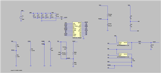

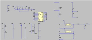

I am trying to simulate with LTSpice the circuit that I would use. The main parameters are: Vin (min) = 18V, Vin (typ) = 28V, Vin (max) 50V, Vout = 12V, Iout = 7A, Switching frequency = 250 KHz.

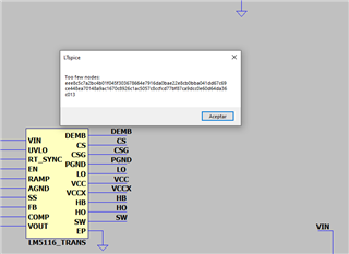

I imported to LTSpice the model "LM5116 Unencrypted PSpice Transient Model (Rev. A)" but when I try to simulate it, I see the following message:
My circuit is:
Have anyone idea about what is happening and how can I solve the node issue?

  • Sorry, this is the circuit with its component values:
  • Hello Nacho
    I am sorry. Unfortunately, TI is not allowed to support LTSPICE and not allowed to install LTSPICE.
    -EL
    No problem. After some modifications I was able to simulate it. IO have a couple of question more:

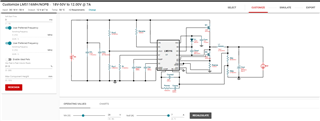

    *When I use the LM5116 calculator I saw some parameters, but if I design with the WEBENCH platform, I saw others value. Which one is the better? If I want to put manually the component values from the LM5116 calculator to the WEBENCH, How can I do it? I need to modify the values to plot the correct one.

    • Please use the parameters in the calculator if any big difference between the calculator and WEBENCH.
    • Yes, you can modify the component values in the WEBENCH window.
