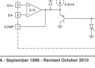

UC2856-Q1: op-amp Symbol swapped
Part Number: UC2856-Q1
I was referring this new Q1  version (May 2011) with predecessor one (Oct 2010), Got confused with error amplifier section.
I found error ampl symbol might get swapped in latest version of the IC which is in Q1, that EA+ should go to the (+) of the op-amp and vice versa.
Find below snapshots: left to right= Q1 and Older revision, Please review and confirm on the same. Thanks
