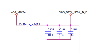

We are using TPS62903RPJR buck in our design where input voltage : 12V, output voltage: 1.8V, output current: 2.8A.
Please check the attached schematic and suggest if any improvements observed.

HI,
Please change C1645 to 0.1uF. Other looks good to me.

i could not find C1645, please check once again i think you might be referring to C165.
sure thanks for the input.
Also can you please shed some light on what role 0.1uF will play?
0.1uf is for decoupling and it can reduce high input voltage spikes.
