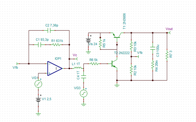

My circuit is a linear voltage regulator (24V to 5V, fixed output):
The 2.5V reference (V1) set the 5V output.
The aim of my tests is compare the loop phase margin measurement with the "indirect" methods: the overshoot of the small step response and closed loop AC peaking measurement.
I use these two graphs as reference:
VG1 performs a 10mV step, to check the Vout time response.

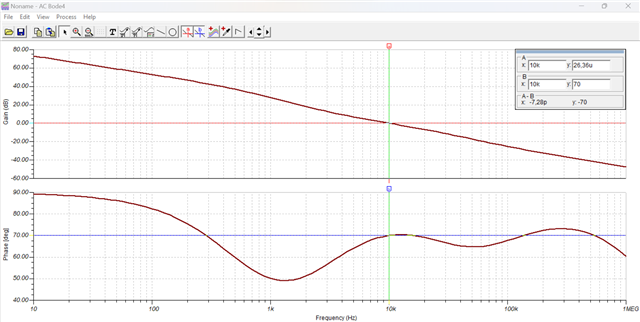

The compensation stage performs a type 2 network, with a phase margin of 70°. I have verified this "opening the loop" in this way:
VG3 performs the AC sweep and I get the following open loop response measuring Vc:
So, the 70° of phase margin are confirmed.

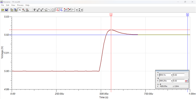

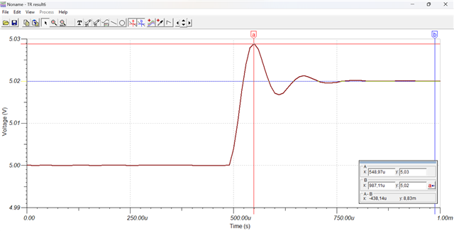

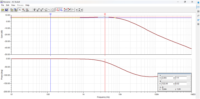

But, if I apply the 10mV step to the orginal circuit I get this overshoot on Vout:

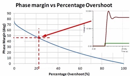

The % overshoot is 100*2.8/20 = 14%   that is typical of a phase margin of 55, quite different from the 70° of open loop measurement.

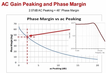

As regards closed loop AC peaking, I obtain 1.09dB that correspond to a phase margin of about 53° (quite close to that obtained with the step response).

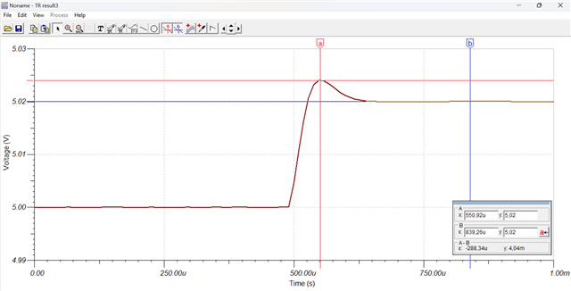

Now, if I apply the 10mV step, this is the Vout:
The % overshoot is 100*4.04/20 = 20.2%  that is typical of a pahse margin of 48° quite different from the 60° of open loop measurement.
As regards closed loop AC peaking, I obtain 1.72dB that correspond to a phase margin of about 48° (the same obtained with the step response).

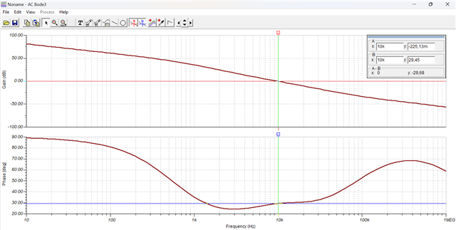

I have modified the compensator to obtain a 30° PM:
The open loop confirms that:

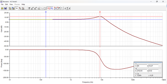

The % overshoot is 100*8.83/20 = 44.15%   that is typical of a pahse margin of 25°, not so different but not equal to 30° of open loop measurement.
As regards closed loop AC peaking, I obtain 6.25dB that correspond to a phase margin of about 28° (quite close to that obtained with the step response).
