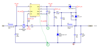

Thank you Sheng-Yang, i have below 2 questions regarding to the schematic connection for PMP9640:
Q1) There is a net connector labelled VSNS (pic below) but i cannot find where it is connected to, may i know if it is used in PMP9640?
Q2) Pin 4 of UCC28710D is labelled as GND but it is connected to BIAS at point A instead of point B at Ground, may i know if this is the correct connection?
Thank you,
Answer to Q1: Right, VSNS node doesn't tie to other place.
Answer to Q2: the connection is correct. We use UCC28710 on a high side Buck. And have the IC sit on the switching node. Therefore, the IC GND is tie to switching node.
