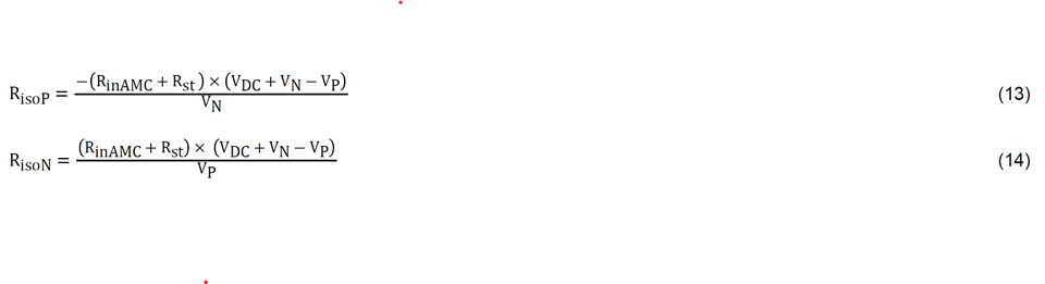

I am using the TIDA-010232 board to calculate the isolation resistance between PE and a 345VDC bus. The measured isolation resistance are with high values of error% as described below.
Calculated Vp and Vn using the below formula equation 18 of the design guide document.
After finding the Vp and  Vn I used these values in equation 13 and 14 of the design guide document
The actual Risop and Rison used between DC+ and PE and DC- and PE are 20K respectively, however by using the above given equations I am getting an Risop of 48K. By analysing the equation 18 I presume that in order to get an Risop of 20K the VinADC value must be 2.08VDC however I am measuring a voltage of 2.343VDC at VinADC measured at singleEndedinADC in pin 6 of J5 in the TIDA board.
I request to understand why I am getting such deviations and how to resolve these deviations.

    You are correct, if SP is closed a voltage of 2.08V is expected at the input of the ADC.
    When SN is closed a voltage of 1.21V is expected at the ADC.
    To find the root cause of the problem, I think its the easiest way to check the voltages across the signal chain.
    I recommend to simulate the equivalent circuits shown in Figure 1-5 and Figure 1-6 and check where the voltages in the measurement differ from the voltages in the simulation.
    Voltages to check are:
    - VP and VinAMC when SP is closed,
    - VN and VinAMC when SN is closed.
     For a symmetrical scenario for RisoN and RisoP = 20k VN would be expected -150V and VP would be expected +150V,  while VinAMC would be expected 264mV and -264mV.
