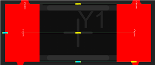

Subject: Clarification on Component Sizes for TIDA-010239 Board
Dear T I team,
I hope this message finds you well.
I am currently working on the TIDA-010239 board, but I have encountered an issue regarding the component references Y1. According to the provided documentation, the value for this CRYSTAL 32.7680KHz 12.5PF SMD but size not mentioned.
Could you kindly assist by providing the correct part number if possible, update the documentation to include this information?
Your support would be greatly appreciated.
Thank you in advance for your help.
BABER SALEEM
info@stingraytec.com
  • Hello Baber Saleem,
    Thanks for reaching out. You are right, there is no part number mentioned in the BOM. We used the ABS10-32.768KHZ-1-T in the design. As the crystel is EOL, I would recommend to substitute it with the CC4V-T1A-32.768kHz-12.5pF-20PPM-TA-QC from Micro Crystal AG or a similar one.
    Here are the Y1 pad dimensions on the TIDA-010239:
    Let me know if you have any further questions.
