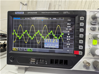

  • Hi Kelvin,
    First of all, thank you for your help. I have some other questions to ask.
    1. When the three-phase voltage in lab2 is under light load, the voltage will increase outward. )
    2.In tinv_37x.h
    TINV_vGrid_A_sensed_pu = ((float32_t)TINV_VGRID_A_READ *
    TINV_ADC_PU_SCALE_FACTOR -
    TINV_vGrid_A_sensedOffset_pu ) * -2.0f
    In tinv_37x.c, you can find
    TINV_vInv_A_sensedOffset_pu = TINV_VOLTAGE_OFFSET_PU;
    TINV_vInv_B_sensedOffset_pu = TINV_VOLTAGE_OFFSET_PU;
    TINV_vInv_C_sensedOffset_pu = TINV_VOLTAGE_OFFSET_PU;
    TINV_vGrid_A_sensedOffset_pu = TINV_VOLTAGE_OFFSET_PU;
    TINV_vGrid_B_sensedOffset_pu = TINV_VOLTAGE_OFFSET_PU;
    TINV_vGrid_C_sensedOffset_pu = TINV_VOLTAGE_OFFSET_PU;
    Can I give different values the offsets of these six values?
    We hope that the value of sw does not differ too much from what is measured by the instrument?
    3. You will hope to minimize this error in lab2
    The main reason is that when we use lab4 to connect to the grid, the grid connection at 110v seems to be successful.
    However, when connecting to the grid at higher voltages (such as 150V/180V/220V), the entire waveform will be completely distorted.
    We wonder if the grid connection fails because the error value is too large?
    4. When using lab4 to connect to the grid, is the correct shutdown procedure to turn off the AC source first and then the DC source?
    Because when we turn off the AC source, the entire waveform will be completely distorted (looks like out of control?)
    Or do we need to turn off the relay first and then turn off the AC and DC sources?
    5. I would also like to ask, how to confirm the current status of the power grid when connecting to the grid? In our understanding, after relay is turned on
    Aren’t the three-phase voltages output by the inverter and those from the grid mixed together?

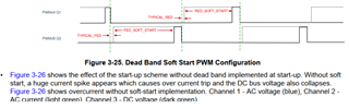

  • Gavin,
    Lab 4 uses TINV_idRef_pu to control the output of the inverter similar to Lab 3.
    The higher the TINV_idRef_pu value, the higher the output voltage of the inverter.  The resistors will burn out if you turn on the GRID and if you wait too long for the relay to turn on (try to turn on within 2 sec).  If you examine the circuit, you will see that the EMI filter stage is basically a reactive load if your GRID is on.  Hence, the resistors will heat up, especially at 230Vrms.  You can fix this by using larger inrush resistors.  Please calculate the power loss of the reactive load at 230Vrms & 60/50 Hz.  Please take care of the resistor power rating issue first.
    In lab 3, when you test the inverter with resistors what was the sign of the TINV_powerRms_A_Watts reading? I believe if the inverter is pushing power to a load, the TINV_powerRms_A_Watts should be positive.  If it's negative, I think you need to increase the TINV_idRef_pu.  Negative power means power flowing into the DC Link as in the PFC mode.
    Are you using a Chroma to emulate the GRID?
    From lab 3, you see that for a given TINV_idRef_pu, different resistive loads will give you different inverter output voltages.  You're basically controlling a current source.  So if the "GRID" impedance is lower than lab 3 resitors, you might not be able to use the same TINV_idRef_pu value.  Do you have an idea of the GRID impedance?
    What is the proper shutdown sequence:
    1. If you turn off the inverter PWM or TINV_idRef_pu = 0  with the GRID still connected AND keeping the relays ON your inrush resistors will be safe.  Next, you can turn off your GRID AC source.  If your AC source is a Chroma, it will probably have its own relays as well when turned off.  Next, turn off the DC source.  Finally, you can turn stop the debugger in CCS and power down the aux 24V supply.
    btw, i would recommend you either increase the power rating of your inrush resistors or use a PTC thermistor for inrush protection PTCEL13R600LBE.
    note: In lab 4, when you turn on the power stage, the inverter is supposed to lock to the GRID frequency (PLL).

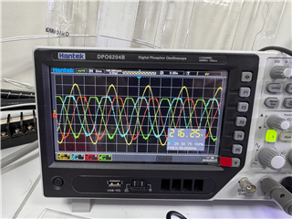

  • Hello
    When testing harmonics today, we used the above settings to adjust the maximum power to 14KW (850V DC/ 254V AC out)
    But when TINV_idRef_pu >0.34 (14KW), the power baseboard will stop output. So are there any suggestions for modifying the above setting values?
    In addition, the following two values ​​were modified:
    Power
    Rated:17000
    Operating:15000
    Thanks:D

  • A few comments:
    1. The 1606 reference design layout was design to support 16Arms of current.  If you want to support higher current, the trace width and thickness must be accounted for and derated for temperature.  There are many online calc tool to help you with this trace width estimation given a current and temperature delta target.  Is this accounted for in your new design?
    2.  I'm concern about the instability of the waveform you saw in lab 3.  This tells me that you haven't got the right compensation values setup.  When i was testing my new design, i had to tune the compensation parameters using COMPENSATION DESIGNER in the main.syscfg.  It's going to be a trade off between the control loop bandwidth and phase margin / stability.    Play around with the Kdc and fz0 values until you get a stable response.  It should be apparent when you get a stable response.  Do not proceed until to high power you stabilize the control loop.
    3. Throughout these tests, make sure to keep an eye on the watch window TINV_boardFaultFlags.  If there is a fault, the PWM will stop and you may have to reset.
    4.  I assume you have updated these parameters in tinv_user_settings.h according to your requirements:

    When I start the PFC, set the negative voltage to 3.18K, AC=220V
    1. open relay
    2. tinv_idref_pu = -0.013 (later revised to -0.009, because -0.013 vbus will exceed 900V DC)
    3. startpowerStage, vBus will change drastically at this time. From nearly 900VDC->850VDC (stable)
    So in Lab6, I started with AC 180V and then boosted it to 220VAC, but I think this is wrong.
    So does this have anything to do with frequency?
  • gavin,
    As a rule of thumb, you would want to set your AC current & voltage sensor HW filter cut off frequency to be a couple of decades away from the grid frequency.  I would be okay with anywhere from 20x to 100x for Fc.  This is to minimize phase error from the filter stage over operating conditions for power factor correction reasons.  For the grid Point of Common Coupling PCC measurements, 5kHz should be fine.  You can add SW filter later if you want to further reduce noise (e.g. averaging).  But keep in mind HW filter is the only stage to target large noise spikes (if you expect them to be there) before it can alias into your sampling.  Once aliased in baseband, SW filtering can't really do much.  there are a lot of material online that talks about aliasing.  Just to give you a heads up on HW vs SW filtering.  There are things you can't do in SW.  For anti-aliasing, you can use LP HW filtering and increase the sampling freq.
    For the switching node current sensing, from a control perspective, you might want to have a bit more BW so 20kHz would be fine.  you could easily change the cutoff later on so it's not a big deal.
    Note, don't get confuse about the filter cut off versus an RC charge bucket at the output.  the charge bucket has much smaller RC values to help drive the ADC to LSB/2.  it basically reduces your op amp BW requirement for a given N-bit ADC and VREF.  TI has an analog designer tool that helps you with the charge bucket design to interface with SAR ADCs.

    1. In the user guide of tida-01606, Page 70. How to set the FED_SOFT_START shown in Figure 3-26?
    2. When using a current probe to observe the current waveform, when setting TINV_startPowerStage, the current waveform will be seriously distorted. Is this normal?
    3. When testing in Lab7, when the output reaches 8KW, the current waveform will change from the positive and upper waveform? What do you think is the possible reason for this?

  • 1. I'm waiting for my colleague to see if he knows about the softstart feature in the code.  I couldn't find it myself on first look.
    2. that current waveform is not normal.  that looks like an unstable system.  you need to tune your compensation until you get a nice sinusoidal current profile.
    please adjust the gain and bandwidth.  the system tends to be more stable when you decrease the bandwidth but this may affect your transient performance.
    3. can you confirm that you have correctly calibrated your current sensors with the right ABS max settings?  also, your controller ADC references are configured to 3.3V?

  • Gavin,
    about the softstart feature, you might want to check out the TINV_HAL_updatePWMDeadBand function usage in tinv.h
