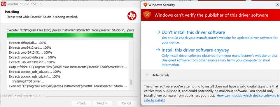

I got LP-XDS110 board with CC1354P10-1 Development kit, as well as CC2652PSIP Development kit with XDS110 on board.
SmartRF Studio 7 fails during installation reporting issues on each driver.
Output folder: C:\Program Files (x86)\Texas Instruments\SmartRF Tools\SmartRF Studio 7\..\drivers\vcp
Extract: ccxxxx_usb_cdc.cat... 100%
Extract: ccxxxx_usb_cdc.inf... 100%
Installing FTDI driver...
Execute: "C:\Program Files (x86)\Texas Instruments\SmartRF Tools\SmartRF Studio 7\..\drivers\dpinst64.exe" /c /sa /sw /PATH "C:\Program Files (x86)\Texas Instruments\SmartRF Tools\SmartRF Studio 7\..\drivers\ftdi"
Driver installation failed with return code -2147352576.
Installing XDS2xx driver...
Execute: "C:\Program Files (x86)\Texas Instruments\SmartRF Tools\SmartRF Studio 7\..\drivers\dpinst64.exe" /c /sa /sw /PATH "C:\Program Files (x86)\Texas Instruments\SmartRF Tools\SmartRF Studio 7\..\drivers\xds2xx"
Driver installation failed with return code -2147418112.
Installing XDS110 driver...
Execute: "C:\Program Files (x86)\Texas Instruments\SmartRF Tools\SmartRF Studio 7\..\drivers\dpinst64.exe" /c /sa /sw /PATH "C:\Program Files (x86)\Texas Instruments\SmartRF Tools\SmartRF Studio 7\..\drivers\xds110"
Installation aborted.
I have tried to install driver manually from C:\Program Files (x86)\Texas Instruments\SmartRF Tools\Drivers\xds110 folder but still without any luck.
See an error:
How to run the setup on Windows 11 that runs under Parallels on Mac Studio?
ST and NXP tools work just fine without any issues, so, it is doable for sure... Please help

    It seems to be a certificate issue. When I tried re-installing this same tool on my Windows 11 PC, I get a message regarding the certificate of those drivers:
    I manually clicked "Install this driver anyway" (it came up about two times), and it eventually installed.
    Did you see a similar dialog on your side?

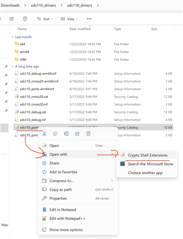

  • Hello Toby,
    Let me lit some light on the issue without re-configuring my environment.
    1. Here is a way how to check driver's cert:
    - select .INF file
    - right click
    - Open with... > Crypto Shell Extensions
    - View Signature > View Certificate
    Check Expiration dates of all certs in the chain!

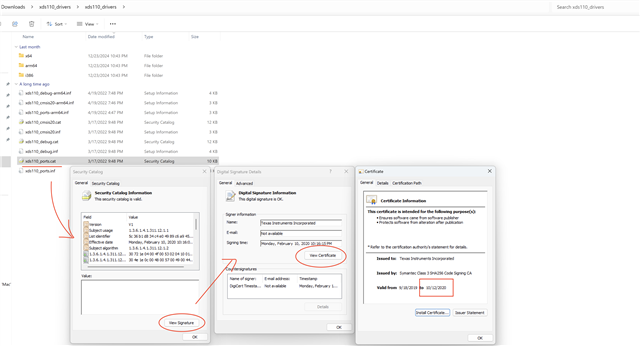

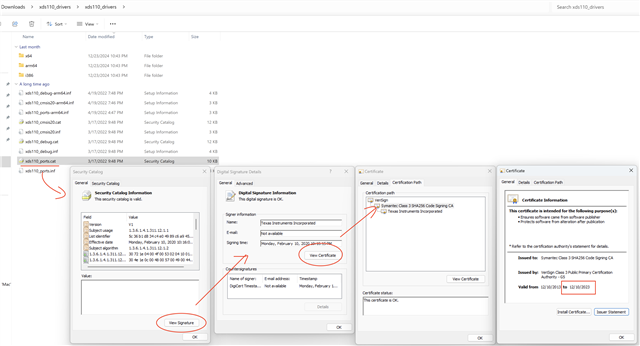

    2. Problem cannot disappear automatically or be temporary, if cert is expired, or any higher level cert is expired, then trust cannot be established.
    In my example, with drivers I got from TI site or TI e2e forum, drivers were signed with TI cert expired in 2020, even CA cert expired in 2023...
    Please confirm you can follow and repeat these steps with similar results.
    3. Depending on Windows config, OS may discard any attempts to install drivers signed by expired CA certs without offering an option to continue (like in your case). It may differ from the case when CA is unknown or untrusted but still not expired. Anyway, drivers must be signed by valid and not expired certs, this will present professional level of the publisher/manufacturer.
