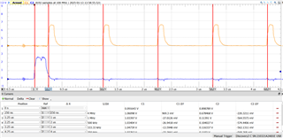

Hello
I am trying to do signal analysis using the TDC7200EVM.
Time1 can read the expected value, but the values ​​from Time2 onwards seem to be abnormal.
The yellow signal in the diagram is input to START, and the red signal is input to STOP.
The first pulse of the STOP signal is successfully detected, but the next pulse and beyond cannot be detected.
I thought that the first and second pulses that enter STOP after Start would enter Time1 and Time2, respectively, but is this wrong?
Or is it a hardware failure?
Please let me know.

  • Hello Issac,
    I am trying to make a program that will acquire five STOP signals. In the output example, the values ​​from Time2 onwards are acquired because the STOP event program has been created. However, it is unlikely that they will all be the same value.
    Is there anything I should be careful about in the program?

  • Hello Issac,
    Yes, 1500[us] and 1600[us].
    The raw data is converted so that it can be easily output via serial communication.
    Does this mean that it is not okay to observe the STOP pulses being output at regular intervals, like in the oscilloscope image?

  • Hello Kimura-san,
    This is what the your data should roughly look like for a capture similar to what you showed above.
    The first one is spaced 250ns from the start pulse and the rest are 1us away from there.
    The TIMEx values generated are the following-
    TME1: 4606
    TIME2: 23126
    TIME3: 41635
    TIME4: 60144
    TIME5: 78651
    with a normLSB = 0.0540346
