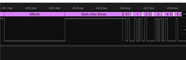

    GPIO_setConfigAndMux is effective for switching pins, thanks for your help. I have one more question about the us delay function,:
    I found that the usleep() function is not accurate, after reading the other problems on the forum, I used the recommended ClockP_usleep() function, it seems to be not accurate either, is there any other solution
    I set a 10-microsecond delay:
    static void DMX_TX(uint8_t *data, uint16_t len)
        GPIO_setConfigAndMux(CONFIG_PIN_UART_TX, GPIO_CFG_OUT_STD, IOC_PORT_GPIO);
        //IO function change
        GPIO_setConfig(CONFIG_PIN_UART_TX, GPIO_CFG_OUT_STD | GPIO_CFG_OUT_LOW);
        //BREAK Frame
    	GPIO_write(CONFIG_PIN_UART_TX, CONFIG_GPIO_LED_OFF);
    	ClockP_usleep(10);
        //MAB Frame
    	GPIO_write(CONFIG_PIN_UART_TX, CONFIG_GPIO_LED_ON);
    	ClockP_usleep(10);
    	GPIO_setConfigAndMux(CONFIG_PIN_UART_TX, GPIO_CFG_OUT_STD, IOC_PORT_MCU_UART0_TX);
       //IO function chang
       /* Access UART */
        UART2_write(uart, data, len, NULL);
    The actual capture:
    There seems to be a change only when the delay exceeds 1ms, as stated in this link: https://e2e.ti.com/support/wireless-connectivity/bluetooth-group/bluetooth/f/bluetooth-forum/1389192/cc2340r5-short-pause-with-usleep-function-1millisecond/5312278?tisearch=e2e-sitesearch&keymatch=ClockP_usleep#5312278
  • Have you seen the following poast?
    (+) CC1352R: TIRTOS usleep precision - Sub-1 GHz forum - Sub-1 GHz - TI E2E support forums
    You can try to use the CPUdelay function:
    //! \brief Provide a small non-zero delay using a simple loop counter.
    //! This function provides means for generating a constant length delay. It
    //! is written in assembly to keep the delay consistent across tool chains,
    //! avoiding the need to tune the delay based on the tool chain in use.
    //! \note It is not recommended using this function for long delays.
    //! Notice that interrupts can affect the delay if not manually disabled in advance.
    //! The delay depends on where code resides and the path for code fetching:
    //! - Code in flash, cache enabled, prefetch enabled  : 4 cycles per loop (Default)
    //! - Code in flash, cache enabled, prefetch disabled : 5 cycles per loop
    //! - Code in flash, cache disabled                   : 7 cycles per loop
    //! - Code in SRAM                                    : 6 cycles per loop
    //! - Code in GPRAM                                   : 3 cycles per loop
    //! \note If using an RTOS, consider using RTOS provided delay functions because
    //! these will not block task scheduling and will potentially save power.
    //! Calculate delay count based on the wanted delay in microseconds (us):
    //! - ui32Count = [delay in us] * [CPU clock in MHz] / [cycles per loop]
    //! Example: 250 us delay with code in flash and with cache and prefetch enabled:
    //! - ui32Count = 250 * 48 / 4 = 3000
    //! \param ui32Count is the number of delay loop iterations to perform. Number must be greater than zero.
    //! \return None
    extern void CPUdelay(uint32_t ui32Count);
    Also note that the GPIO_write function take a finite time to execute, so you woul need to compensate for this.
    BR
    Siri
  • Thanks for your answer, this function works very well
