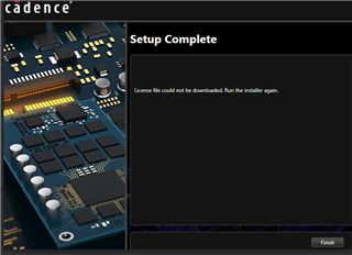

 can not open the Tina simulation, receive message after installation.
I got approval from TI and access key

  • can you pull some data to help with debug?
    You'll need to setup an environment variable.
    CDS_LIC_QA_TesT environment variable
    The CDS_LIC_QA_TesT environment variable is a testability code that is set on the client system running the Cadence tools. The variable is set for troubleshooting Licensing issues. CDS_LIC_QA_TesT must be set before the invocation of the Cadence tool. The value of this variable is any writable area on your system.
    Windows:
    Access the Windows button, search for edit environment variables for your account.
    New > CDS_LIC_QA_TesT = c:\cadence\qalog.txt
    After setting this variable, invoke the tool. If you get a Licensing error, send the qalog.txt file to Customer Support. The qalog.txt file can grow quite large over time. Hence, it is best to unset the variable when your problem is solved.
    Note: Do not set this variable in c:\ drive as you may not have write permission there and the file will not get created. Please set it either in c:\cadence or in a different drive like d:\ .
    After that's setup, then per Cadence,
    uninstall the tool and re-run the installer (with CDS_LIC_QA_TesT variable in place).
    Post the file here. Insert->Image/video/file
    David
  • One user has had success installing in admin mode.
    Please uninstall using add/remove program. Then re-install in admin mode.
    Let me know if that doesn't work.
    If you've setup the environment variable and it doesn't work. Please attach the qalog.txt here.
    If it does work, please remove the environment variable as it will continue to collect data and get very large over time.
    David
  • Multiple reports of successful installation now. Closing this thread, but if you still have problems, please either re-open, or submit a new post.
