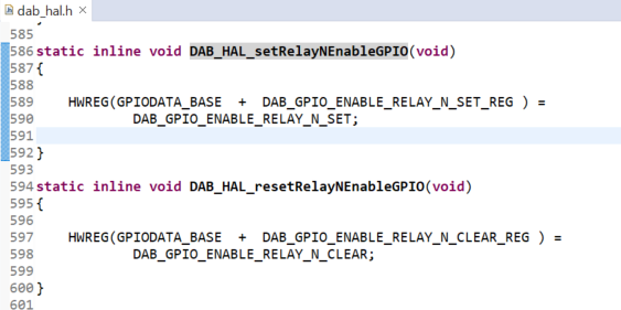

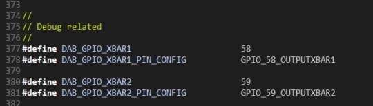

(2). There is GPIO redefined. Debugging and Relay control are in conflict with GPIO58 but it's not used, is there any consideration that remains / keeps in the source code ? any use / design concern for that ?

    (2) GPIO 58 is only used for the relay control. The XBAR configuration is not needed.  I think it is a relic form a previous version.
