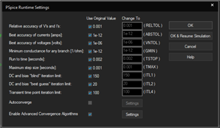

we have developed a simulation model for flyback 100kHz application. all the recommended values has been placed as per datasheet.
but it gives convergence error.
can you help me in resolving this
below is the error from pspice. also attached the screen shot as well.

    Yes, the issue is due to convergency, but it looks the convergency comes from external circuit parameters not from the UCC28C56 model since the attached simulation is ok to run from our side, you can check by running this simulation file.
    The convergency usually needs to get fix through change the convergency settings by modifying the below as you know (you need try each to increase a bit at a time then re-run to find out - it is time consuming - but it is a simple trial-and-error). Another way is to check your design to try to get rid of not necessary circuit or components or change small value to be slightly bigger to avoid small time constants as these will need better resolution to get convergncy.
    Another way is to start with the attached and modify some at step to simulate to know which causing convergency.
    We do not know other tune up methods. You can also contact the PSpice vendor to get their help or advice how to resolve convergency issue in general as we do not have this team anymore so please contact the PSpice vendor to get more help.
    UCC28C56H PSPICE Check.zip
  • With the convergence settings available in the simulation file shared by you. convergence error is resolved, but can you help us in running the simulation faster . it is taking much larger time .
