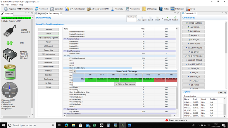

  • How do I configure the register for short-circuit protection?
  • The short-circuit discharge configuration register in BQSTUDIO differs from the reference manual. How can I effectively protect the ASCD?
