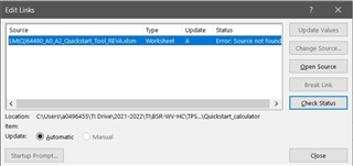

Question 1:  The following look like leftovers and a broken link from copy-paste errors.  What functionality is the spreadsheet missing?
When opening the tool in Excel and enabling active content (bar at top), I get the following notice:
When I click on either "Continue" or  "Edit Links..." I get:
When I open the highlighted link source, I get:
A path on a TI computer or server perhaps?

    Question 1: The links are links to old TI sites that are no longer accessible. Those links are not vital to the functionality of the calculator and can be ignored.
