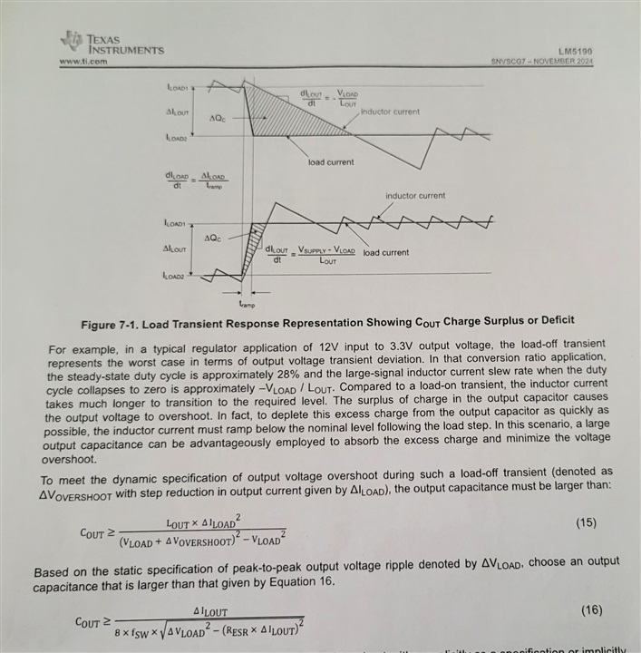

Hello Karthik
Load step is an electrical requirement defined by the customer.
ILOAD is load current. ILOUT is the inductor current
LOUT is the inductance of the power inductor.

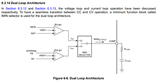

3.How Imin selector selects current loop error(selection).

3. Please refer the section 6.3.14 in the datasheet. It is not allowed for me to disclose more details inside the IMIN selector.
