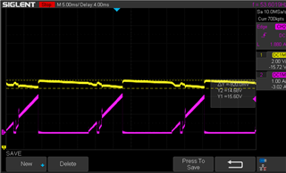

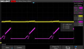

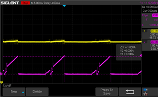

and I'm charging with a 65W PD charger that is supplying 15VDC VBUS per the protocol.  I have an odd thing happening towards the end of the charge cycle.  When the battery charge gets up to around 15.8VDC the charger starts going in and out of charge indication.  The charge current peaks to around 1.8A with indicates to me tha tit should be in the Constant Voltage charge mode on the decaying charge current curve.  When the current peaks, it is pulling the voltage at the battery connector up to 16.4VDC and seems to shut down.
It stays doing this slowly charging the battery up until it hits around 16.2VDC as measured with a meter, then it falls back to constant voltage with the current slowly decreasing as expected and a constant indication of charging until fully charged.  I'm not sure what would be causing this.

  • An interesting thought.  I have reproduced this with two different batteries, and in each case they charge with a constant 2A prior to hitting this stage.  Then they have this issue until they reach the point where the current doesn't create the voltage ripple at the battery (or at least that's my assumption as to why it stops) until it reaches the current cut off point.  Since the battery protection circuit holds at the 2A point, I'm not sure what whould cause it to be instantaneously opening and closing as to have the waveform shown.

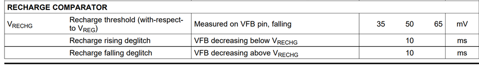

    BQ24617 recharge threshold is 50mV multiplied by the feedback divider, so 2x50mV.  Its deglitch time is shorter so I would expect BQ24617 to toggle more frequently.

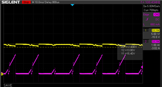

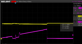

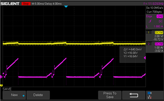

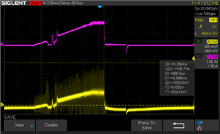

  • Ok, I had the software group change the recharge threshold from its default, to 400mV, but I still see the issue so I'm back to assuming its some sort of noise issue probably caused by something in the layout.  Here are some additional scope shots I've taken while is in this oscillation/restart mode.  The top trace is current, and the bottom trace is the ripple voltage on the VBAT pin taken on C12 (100nF).  The battery charge current is set for 2A and as you can see this appears to be operating within the constant voltage phase of the charge cycle because the charge current stops at ~1.6A.

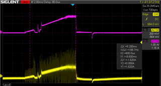

    This is the same scope shot but the cursors are on the voltage ripple.

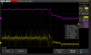

    and here its zoomed in that shows some sort of ringing that sarts up that appears to be either the cause or an effect of the shut down.

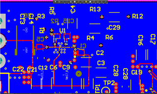

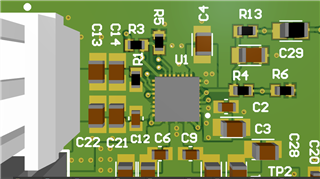

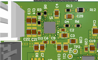

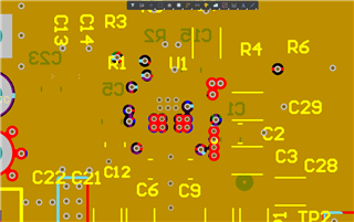

    Here's a top view of the current layout

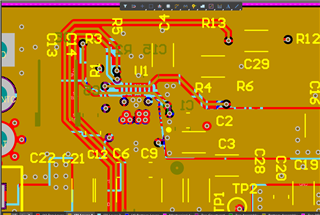

    And its a 4 layer board, 2OZ copper.

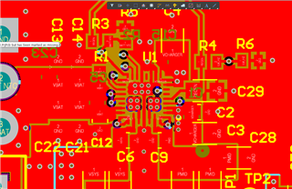

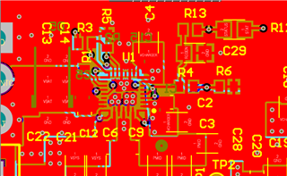

    So looking at the layout, here's the changes I currently have in place

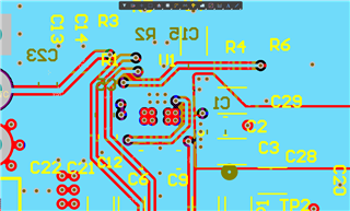

    On the top layer I modified the ground vias so I was able to get a ground flow connection from Pin 27 though to the ground connections on the opposite side of the chip.  It also allwed me to move C6 and C9 a bit closer to the chips pins on VSYS and PMID.  I also moved C29 so it is directly off of pin 5 REGEN.

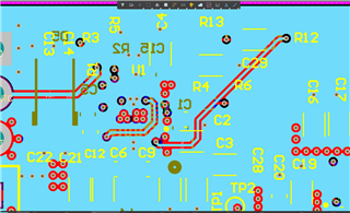

    I moved a bunch of the signal traces off of layer 2 to get a more solid ground plane directly under the chip

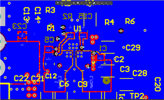

    On the bottom layer I centered the inductor with the chip on the top of the board and allowed ground flow under the inductor flowing through under the chip.
    Any thoughts regarding what I can do on the current boards to address the odd operation, and comments on the new layout?
  • HI Michael,
    The new layout follows the PMID and SYS capacitor placement recommendation so I expect IINDPM and ICHG regulation to be within spec.  The SWx pours/planes to the inductor are quite large and have ground immediately under them.  Those pours/planes and GND form a pulsing capacitor that spews EMI.
    Your charge profile is still puzzling.  I don't understand why the charge current ramps up so slowly.  This part does not have ICHG soft start.  What do the status and fault registers in REG0x1B-0x27 report during this time and then immediately after the drop off?  The ramp implies there is a variable resistance somewhere in series between the BAT pin and pack battery cells.  I suspect the sudden drop off in voltage is due to voltage created by a fixed series resistance x ICHG being removed when the charge enters termination.
