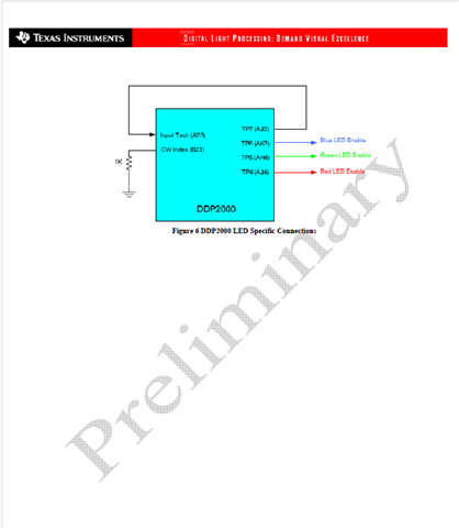

  2. I am not using PWM, there is only three ENABLE signals RGB (Please refer to image) simulating color wheel. Please suggest, do I need to make any change to VREF(PIN5) and IADJ(PIN6) circuitry if I am not connecting any PWM signal.

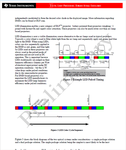

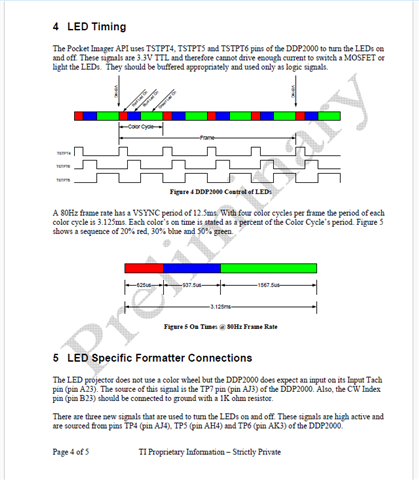

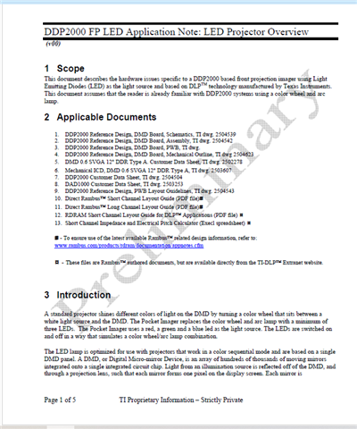

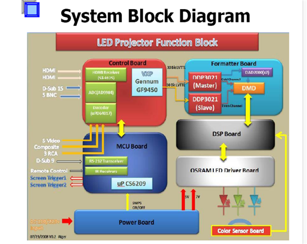

    My initial assumption was based on documentation where it says that the LED Projector simulated a color wheel using only three ENABLE signals(RGB Image5). Please have a look at all attached images(I have numbered them in order).

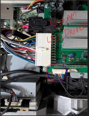

    If you look at image 6 & 7, there are many wires connected between the LED Driver board and DSP board. Would you be able to tell what these wires are for. Three are definitely for RGB ENABLE, how can I identify what are rest of wires for.

  • Hello Marvin,
    This design is just an LED Driver board, the design suggests that your circled connector (J400) could house enable signals, PWM signals and the subframe/sense line.
    I'm sorry I don't have a full design for this system but that would be my guess based on photos and your descriptions.
