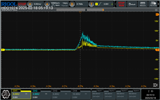

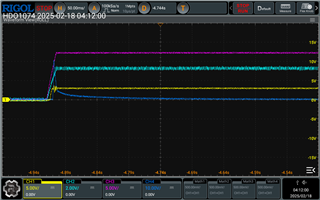

    I have observed the input, output, PG voltages, and the enable voltage. The input voltage appears to be fine, but there is no output voltage. Additionally, after powering on, the PG voltage does not go to zero. You can see the waveforms below.
    (Pink - Input, Light Blue - Enable, Yellow- PG, Dark Blue - Output)
    According to the UCC14141 datasheet, if the PG pin behaves this way, it indicates a potential fault in the FBVDD and FBVEE pins due to UVLO. I also tried reducing the R12 value and rechecked the output, but the fault persisted.

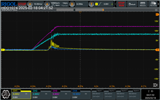

    Next, I measured the voltages at the FBVDD and FBVEE pins and observed that, during startup, these voltages rise momentarily but then suddenly drop. You can find the waveforms below.
    Based on these observations, I identified an issue with the output undervoltage protection. I measured the voltage across C283 and C284 and noticed that these capacitors suddenly discharge during the startup process.
    To address this, I removed capacitor C283 and replaced C284 with a 0.1 µF capacitor. This resolved the issue, and I am now able to get the correct output voltages.
